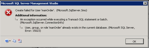

Error while doing user mapping in MSSQL: Create failed for User (Microsoft.SqlServer.Smo)
Issue: After restoring the axpert database in mssql, there is an error as shown below when mapping the db user login with the default database.
Steps to resolve:
Run the below command on the restored database using SA login.
exec sp_change_users_login 'auto-fix', @userVar
