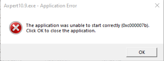

Error: The application was unable to start correctly (0xc000007b). Click OK to close the application.
This error may popup, if the newly compiled binaries (exes) are used without the latest open SSL dlls (libeay32.dll, ssleay32.dll) on axpert folder.
You can download the latest open SSL dlls from here.
OPEN SSL DLL 64 Bit
OPEN SSL DLL 32 Bit
(After downloading the file, extract it, then copy ssleay32.dll and libeay32.dll and place those files in the Axpert root folder )
